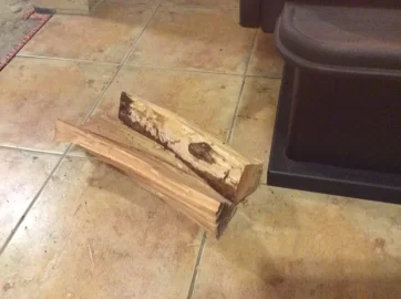

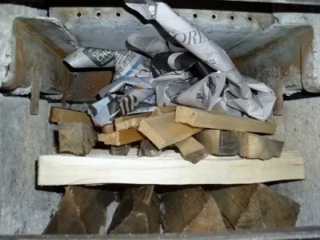

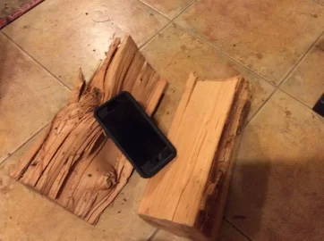

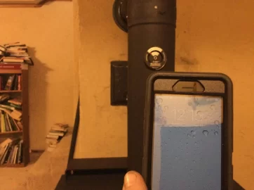

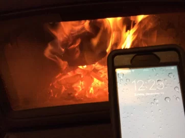

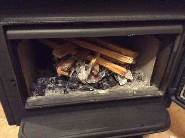

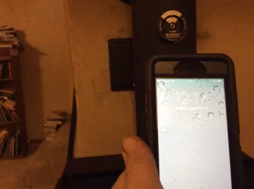

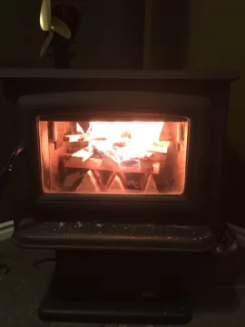

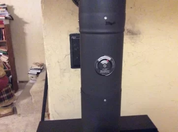

Cold start up PE Summit pedestal. Fir kindling and fir wood. I always start up with a crumpled newspaper and crisis cross of kindling on top. Generally I have very pitchy kindling. But well cured wood so very cured pitch, crumbly almost. I start on kindling and then to a few small splits and right into bigger splits. The door was closed in the first minute and only opened again to add wood, never 'cracked'again after the 1st minute to help draft. Here's my times and some pics to show what it looks like and what I'm using at each step.
12:10 start
12:11 close door
12:14 add smaller splits
12:15 stovepipe thermometer moves up out of creosote zone
12:18 add a few more smaller splits and thermometer is more than halfway through the "best burn" zone
12:26 add large splits thermometer continues to climb
12:30 shut air to half max temp on stovepipe.
12:33 cut air back to 1/4" open lots of secondary's
12:34 cut air to 1/8" lots of secondary's.
12:38 running air about 3/8" temps are starting to come back down off max, slowly.
12:56 check the stove and cut the air a bit, still running in the hotter end of the "burn zone" and lots of secondary's.
From here the stove is up and running and I may have to turn it up a bit or down to maintain good secondary's and stay within operating range on my stovepipe. The only time it would creep down into the creosote zone would be on a overnight burn when it's all coaled up. I have very little ash, in almost a month I've scooped a bit out once, all the wood burns down completely if I let it burn out. I've never cleaned the glass on this stove yet and I'd have to estimate about 1/2 to 3/4 of a full cord of wood is what I've burnt so far.
I'm wondering people's comments/suggestions on my methods.

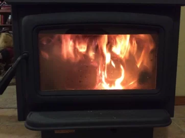

Rest of pics. Hope it's ok to put up so many. Last two pics show the fire at 12:56. [Hearth.com] PE Summit Pedestal Cold Start Up[Hearth.com] PE Summit Pedestal Cold Start Up[Hearth.com] PE Summit Pedestal Cold Start Up

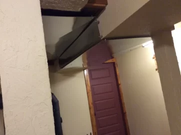

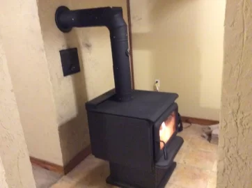

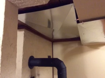

A couple more pics showing the general setup and my heat shield. I did all the installing myself.
[Hearth.com] PE Summit Pedestal Cold Start Up [Hearth.com] PE Summit Pedestal Cold Start Up [Hearth.com] PE Summit Pedestal Cold Start Up
So to recap I'm about an hour and fifteen into my burn and I've used 12-15 small pieces of kindling four small splits and then the two big splits. Air is currently shut right off and the stove is cruising hot with lots of secondary's and I would estimate four hours until I'll need to reload.
I should also add this start up is at 3Celsius outdoor temp. My chimney is 23' to stovetop with a uninsulated interior chimney lined with a nova flex 6" stainless liner. That was all I could fit down my 8x8 tile lined masonry chimney.

Also would like opinions on whether it would be worthwhile going to two 45's on my flue pipe instead of the 90? The inspector who certified my install first mentioned it to me and was kind of a miss on my part to not have thought of going that route. I don't know that it would be worth it to change it out now though as I may as well use up the useful life of this piping as I feel the setup is performing well and don't know that I'd see a lot of benefit from trying to improve the draft more?
Reactions: Seanm
PE stoves with the baffle seem to be more forgiving as far as draft. I think it's the smoother ceiling of the firebox and easier airflow through the baffle, as opposed to having two or three tubes up there.
Going to a pair of 45s can only help, but I don't know of many stove that you can just rip the door open. Slowly opening the door is pretty much the norm. You should see draft improve with colder outside temps.

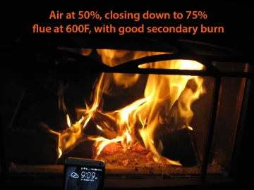

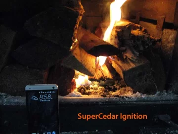

Heres a picture of a top down fire from my archives in my super 27. Same stove but yours has the more envious fire box size. I will light two fatwood fire starters two rows down, no paper (personal preference). Close the door, air wide open, monitor flue temps and to a lesser degree the stove top, after a bit the air is "closed" down in increments, timing dependent on dryness of wood and out door temperature (aka draft), then I walk away for an hour or three until its time to rake the coals forward and fill er up! With the air wash on these stoves the glass should remain clean at this stage. Beautiful stove by the way!

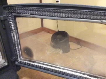

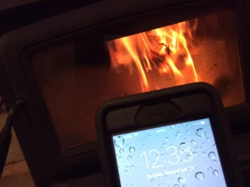

Tried a quick start this morning in the T6. 10 minutes to secondaries, 12 minutes to air fully closed. Man this wood is dry.

I like sticking my firestarter part way down. The idea is to get the top kindling and smaller splits blazing quicker than the big stuff, secondaries will light off quicker to, It also helps put more heat up the chimney quicker which helps reduce creo build up. Glad you like it. I learned how to do it from the good folks on hearth as well.
The not having to open the door seems to be a big advantage. No heat loss.
In the sequence I posted the SuperCedar quarter chunk is at the bottom. The trick for quick ignition is to have smaller, dry pieces in the flame path with plenty of room for air and flame to travel upward through the wood, igniting larger pieces along the way.
