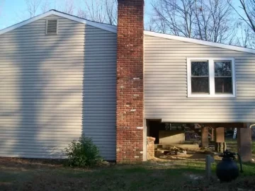

The huge off-set is because it is a corner fireplace and it sticks out into the room several feet. The chimney is lined all the way to the top with 6-inch SS flex liner. I guess there is a possibility that the liner was torn slightly when the installer pulled it through the off-set, but not sure. Maybe I'll pull the insert this weekend and reach up to the off-set and snap a photo inside the off-set area and see if I can determine the condition of the liner.

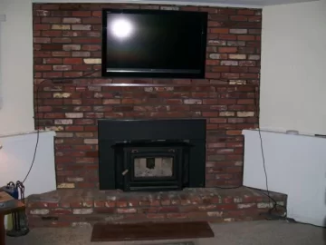

Ram, it can't be good for your tv to be right in the path of the heat rising from your insert, no?
I was thinking the same thing.
But does look like he has a deflector in between them.
Yeah, but it's still the warmest spot in the house...
I'd love to put mine above my stove too, but have been balking for that very reason.
Actually, the TV doesn't get hot at all as long as the blower is running and I run the blower on low-medium all the time once the insert is up to temperature. Also, I have a granite mantle shelf that sticks out 10-inches from the brick, which was a left over piece of granite from a granite shop and they sold it to me for $60.00. It matches the granite hearth extension. They sold me the extension for $40.00. They even cut it and rounded the edges for that price.
