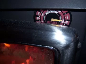

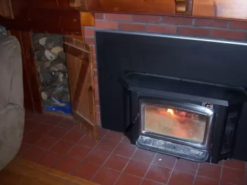

been very busy and havent had time to reply to this thread, but I have a couple pice for you regarding the thermometer and placement. This is how Hog suggested I do it and I have had good luck and great burning.
Ray_Pa, Great pics. I'm new to all of this, but from what I can tell,your thermometer is showing overfire. Is that the temp you burn constantly? Not sure how all of this works, thats why I'm asking.

I wouldn't put a great deal of faith inthe thermometer readings. I have two of those side by side on my Lopi and they will read from 100 t0 250 degrees different at any given time. However YMMV...

There isn't any universal answer for this question. Different locations on different stoves are going to show different temps. Some stoves cruise at 400, some at 600. And the general point about some of these thermometers not being too accurate can be true. But for a Summit, 700-750 is not an unusual temperature when a full load of wood is hot and in full secondary burn. For other stoves, this would be a bit hot.
Note that the temperature range indicators on this type of thermometer are for when it is being used on a single wall flue pipe.

I dont know if the thermo is is calibrated, I just use it as a guide. I will say that the 'overfire' indication on it is not accurate for a stove surface, it may be for a flue. When I load it full with good dry wood and the secondary burn kicks in, it will run at 750-800 for 40 minutes or so, then slowly back down to 600-650 and stay there for a couple hours. The first few times this happened, I felt very uncomfortable, so I talked with iceman, hog and karl on here, who all run summit inserts and all of them told me to relax, its the nautre of the beast...and they were right on the money. I have burned 24/7 since October, let the fire go out today, as its supposed to be 60 here...chimney is very clean and once I cleaned up the stove and glass, it looks like the day I took it out of the crate.

I have a burn indicator / thermometer, in the same palce as Ray. Almost always around 700-800 when burning well - around 30-60 minutes after reload, secondary burning well, draft cut back. They are "meant for" the stovepipe, so the overfire warning does not apply. Mine is very accurate, as checked by an IR temp gun.
