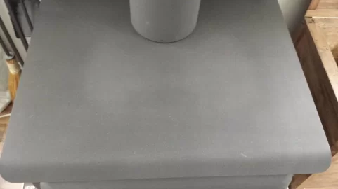

I've been burning pretty much 24/7 for about 6 months with a new PE Summit and I'm starting to see some faint greyish blotching on the top. I keep the top plate temperature under 750 degrees but have hit 850 once or twice. Just wondering if this is normal or if I'm burning too hot?

You are running it pretty hot. But not hot enough to damage it, I just wouldn't leave it at these temps for long periods of time.
Fading paint is normal in the hot spots, especially in flat black. Just grab a can of Stove Bright and touch it up after the season is over.

Jwilliam, are you seeing the 750-800F temps with the blower on or off? If the blower is on, that's much too hot. If the blower is off, then it's about 100F hotter than I run our stove.

Those temps are with the blower off although it has been at 700 with the blower on low. I'm pretty sure it was before the stove had ever been to 750 when I started to see the discoloration on the top

OK, that sounds more normal. I try to keep it a bit lower. Our thermometer only goes up to 750F. Over 750F causes our thermometer to round trip past 0F. With good hard wood we've seen it pass 750F on occasion when burning good hardwood. This mostly has happened due to my turning down the air too late. Turning on the blower quickly drops the stove top temp down 100-150F.
This summer with the windows wide open you could repaint the stove top with StoveBrite metallic black. If you do put an fan in one nearby window exhausting out the fumes. They are brain-rottingly bad.

What about kettles? Have you placed anything on top of the stove with water ?
Actually I had put a kettle with water in it on there for one evening but that was a while before I started noticing the paint. I also put an eco fan on there once in a while but not really where the paint is changing color

That haze looks like possible beginning signs of over-firing. You may want to run a pipe probe or surface mount on the pipe also and keep track a while.
The stove top and pipe doing the same looks like running too hot to me. But, I have been know to be wrong from time to time.

The new flame shield inside the newer stoves ceilings now has a deflector which basically is a wall the flames hit and go around, prior to reaching the outlet. This to me creates a hot spot where the flames are being blocked and diverted in front of the deflector.
This is right where your fading is in front of the outlet.

Yes its exactly where that deflector is. You wouldn't think it would be so easy to over fire these stoves? It gets up to 500 easily with just a small fire
