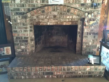

After combing through the forum I am now left with a hard choice to make. Do I go with the larger Summit that I'm afraid will overheat the room that I spend most evenings in unless I run it at less than optimal capacity, or move down to the Super and run it at it's rated capacity. The Summit will fit in my fireplace, but a custom surround would be needed. The Super will fit with the standard surround just fine. Money is not the issue and since both stoves load n/s the decision to be made is whether to get the bigger stove, run it at a lower temp and risk creosote build up or buy the Super and just be happy with a smaller box. I called PE's customer service yesterday to ask a question about the Summit and after talking to the rep he recommended going with the Super as it is easier to get lit. Any comments or thoughts to help me make a decision today?
I think we would need some more info to help you. How big is the room? How many sqft do you want to heat? Why does the Summit need a custom surround? (Do you have a pic of the fireplace?) You can also judge your heating needs by knowing how much heating fuel (gas, oil etc.) you usually use during a cold month like January. A floor plan would also help to see how well the warm air may flow around your house.
My room is 18 x 14 with a open ceiling to the upper 2 bedrooms, there are 3 door openings in the room and one is a double doorway into the kitchen. I have a 95% efficient nat gas furnace so my gas bills are low, last Dec gas bill was $103, Jan was $200, Feb was $178, so I'm not going to be heating my whole house with wood. My fireplace has a Dutch arch which is 44" wide that the insert would fit up to and the Summit with a standard surround would not fit in there, the Super with standard surround will fit.

Since I got bids on both stoves there is only a $350 up charge to get the Summit over the Super, but I'm not getting a surround with the Summit. Should I just get the bigger stove?

I think I will go ahead and order the Summit and if I don't use it's full capacity at least I know I have some headroom if I need it. Thanks for all the advice.

I went ahead and ordered my Pacific Energy Summit with a Dec 1 install date unless they have a cancellation before then. I will be building a custom surround as soon as the unit comes in and I get exact measurements of the stove. Thanks for all the comments pro and con about the units, it seems that I couldn't have gone wrong with either insert. I now need to order a hearth pad, poker set, ash pan and thermometer. Mike
