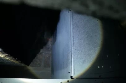

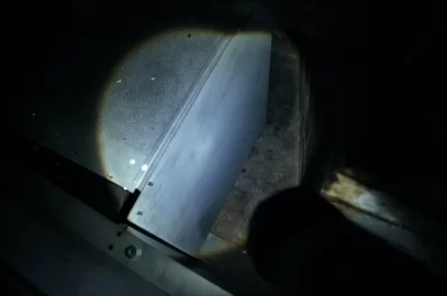

I took pictures of both sides of the unit this morning. I guess the knock outs are in the metal casing? I don't see any indentation or punched slit.
  • [Hearth.com] PE Vista side knock-out
