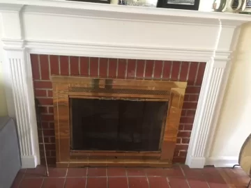

These are the dimensions I’m worried about:
Minimum required height of pedestal if the hearth is not to-code: 4 ½”
Height of i1500 itself: 18 ¾” (¾” more where flue adaptor is, which doesn’t seem relevant)
Minimum required clearance from top of insert to combustible trim above: 15”
Total needed from floor of fireplace to base of trim: 4 ½” pedestal + 18 ¾” insert + 15” to trim = 38 ¼“
The distance from the floor of our fireplace to the base of the white-painted trim (visible in photo) is just 37 ¾”. [Hearth.com] Pedestal on an insert?
So, if adding a pedestal is feasible, we would remove 1 ½” of the underside of the trim. This seems much easier and less expensive than replacing our hearth (which would probably be a deal-breaker for us). But I’m worried that I’m missing something - or missing a lot! In your experience, is this plan workable?
The distance from the floor of our fireplace to the base of the white-painted trim (visible in photo) is just 37 ¾”. View attachment 302492

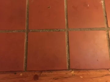

How far will the hearth extend Infront of the insert?
Thank you for responding. The hearth would extend 16 and 5/8" in front of the body of the insert. The bottom of the insert - I don't know what it is - juts out an additional 3 and 3/16". The hearth would extend just 13" and 7/16" in front of the insert if I include the "jut-out" as part of the insert. The bigger issue, I believe, is that our hearth probably doesn't have the R-value that it would need to serve as a hearth in front of a wood burning insert. That's why I'm wondering if that can be solved by putting it on a pedestal - and whether that's possible.
Here's what the documentation says: "Thermal insulation/protection with a R value of 1.4 at a distance of 18" from door opening is required for Canada and 16" for USA. If unit raised minimum 4.5" from hearth, no thermal protection is required."
Here's a link to the spec sheet - https://assets.regency-fire.com/getdoc/8b1aad23-16e3-4125-b5a8-2f4d743b86e4/I1500-specsheet - the bottom right diagram on the first page shows the "jut-out". Thanks so much.
I know the regency specs. How is your current hearth extension constructed?

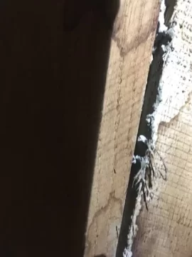

Looking up from the basement, I can see concrete between the underflooring boards. It couldn't be very thick but it is there. As far as I can tell, there isn't a wood form under it. But the other parts of the basement ceiling boards have something else above them, not concrete. This image is looking up from the basement - there are a few small pieces of excess concrete between the boards that are the ceiling of the basement.
Is the sub floor under the hearth extension at the same level as the rest of the subfloor?

You have the room to raise the fireplace floor. With The right size bricks one course would be all it needs finish the front edge however you like. That said one could easily put down, in a permanent or semi permanent manner, an insulated hearth pad. Yeah they don’t look great but it’s a relatively cheap and very fast solution.
That is so helpful. So, we could lay one layer of bricks that are 4.5" high and put the insert on top of them and we'd be all set? We are not experienced DIYers but that sounds like, after watching a bunch of Youtubes, something we could do. (And, alternatively, we could put down an insulated hearth pad.) Thank you! I'd about given up that we could solve this.
Yes as I suggested earlier I think a hearth pad is the best solution
Thanks for noting that - could you possibly explain what's better about a hearth pad? Does a hearth pad go under the insert as well as in front of the fireplace? Or just in front of the fireplace? Thank you.
Well it would go under the front of the insert that extends out of the fireplace. You would then pad up under the insert so it sat level
A custom non-combustible hearth pad with the right insulation value could be made to start under the insert and extend out to 16 or 18" beyond the stove door.
I now see that the floor below our hearth is actually 4“ thicker than the floor below the rest of the floor and I can see concrete from the basement looking up. Can I assume that it therefore has the necessary R-value for underneath the hearth?

Take the wooden forms off of the bottom of the hearth and r value doesn't matter.
And yes you absolutely need to take any manufacturers clearances at face value. Those are the required specifications
