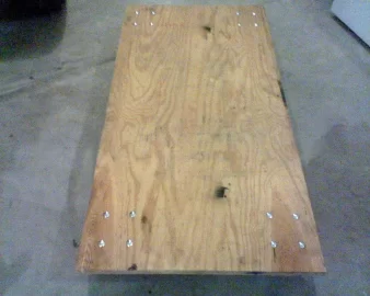

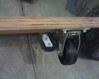

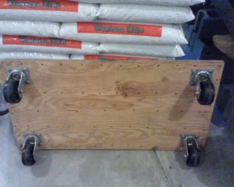

lets see a picture of your cart? was going to make one myself over the winter
This is the cart that I built for my insert.
[Hearth.com] Pellet Insert Removal [Hearth.com] Pellet Insert Removal [Hearth.com] Pellet Insert Removal
I used 4 swivel casters for the wheels and two pieces of 3/4" plywood for the top. This worked out to be the perfect height to be able to slide the insert out onto from the hearth.
