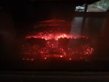

Just thought I relate my experience with the reusable stainless steel pellet log cages I just recieved in the mail over the weekend, You get 4 in a set, $34, graduating sizes so they all fit inside each other for storage. I cut a cheapo funnel to fill 2 and tested in the outdoor fire pit. They come with 2 stands, just 10" v-shaped stands of same material. I was surprised how well they worked, though they take some time to get a healty fire going. I think I could use a little more kindling, I wanted to use the smallest amount to start with. As the logs burned out, the ash falls out. After the fire was out, a few shakes and it was ready to fill again. And they cool down surprisingly fast when taken out of the fire.
Next I put 1 of the larger logs on the stands in the wood stove with some small sticks for kindling underneath. Closed the door and it took right off, seemed to work better in the stove. I could see the red hot pellet core in the basket after turning the air down. I'm going to get a new bag of pellets tonight and test 3 logs at once in the stove and time the burn. So far so good.

update: did another test this weekend Sunday morning. I put the 2 biggest cages (with Somerset pellets) in the Regency at 10:30 am with a small SC chunk between them. Cages took off with no fuss, creating so healthy a fire in about 20 minutes, that I had to turned down the air. At about 50 minutes I turned the air down again and had good glowing cores and fire off the top (secondarys ?). This went on for another hour. All tolled the load lasted about 2.5 to 3 hours. That's not long, but consider these 2 cages are 3 1/2" x 12" and 3" x 12". I used about 4 or 5 plastic dixie cups to fill each one. I need to measure exactly the amount of pellets used for a whole set of 4 logs. But I think you can fill all 4 at least 10 times with 1 bag of pellets at $4.59.
My next test will be all four at once in the Morso.
