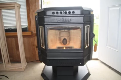

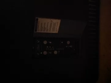

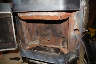

I purchased a Whitfield this evening that I can not seem to identify. The decal on the inside of the hopper lid was removed. It has the LED style control board, and there was a module on the inside with a manufacture date of 1999. Is there any way to get a positive ID on the model? In the attached pictures you can see I got carried away with dismantling since I found a decent amount of rust flaking off. I need new brick and baffles and while I'm at it maybe a paint job. The model would help me with the brick and baffles but I'll take suggestions on paint (inside and out). Thanks,

Hi Kris, welcome to the forum and congratulations on your purchase. You won't regret it... that stove is one of the best ever made and with a little elbow grease, it will soon be throwing a lot of wonderful heat out in your rooms. I'm convinced that your stove is an Advantage II-T ( Classic? ). Your stove is similar to that on the attached photo, right? I hope this picture from the original Whitfield brochure may encourage you in the restoring job.

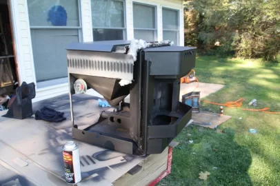

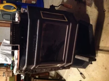

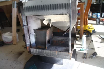

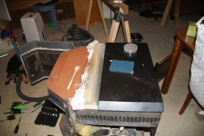

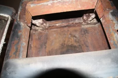

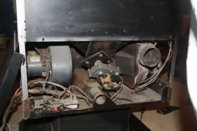

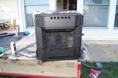

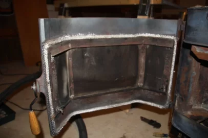

Well this thing has started to get a life of its own. Has anyone done a post documenting a complete whitfield rebuild? I am at the point where I should decide how far to go with this. In some of the pictures you may see the large amount of rust. This rust resembles the rust that develops from direct contact with water not just damp air. Since I have no idea what the serial number would be I believe ill be guessing on the gasket part numbers at this point. Any help would be greatly appreciated on the direction I should take this.

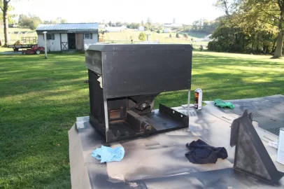

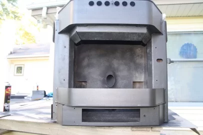

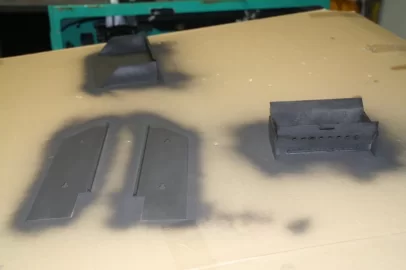

Here are a few of the pieces I sandblasted today. Couldn't find a good high temp primer so I'm just hitting these with a base of black to keep the pieces from rusting.[Hearth.com] Pellet newbie with a Whitfield full of questions.
I have an even older Whitfield Quest (1994) and just love that old stove. A wire brush and paint stripping pad on a cordless drill can do wonders for this rust. Wear eye protection and a good dust mask or respirator.
I found gaskets and parts at Mountain View Hearth Products, and they have a tech who can speak to you directly. Here's a link to their site: http://www.stove-parts-unlimited.com.
For paint, I use high temp black paint, available at most home centers or at any decent stove shop. Do NOT use regular paint!

this one has the thermostat connections (the little red jumper next to the power), and the igniter relay (the little black box laying down just behind and to the right of the tstat connector)with the red wire and fuse holder.)
Looks like the IIT (I have an insert).
As far as tearing down too much, na.
I just bought gasket material from home improvement store by bringing in pieces of old gasket to compare. Would suggest getting the graphite impregnated gaskets if available. I think it will last longer as the graphite will keep the rope from sticking and compressing. Igniters are overated on heavily used stoves. A propane torch is more reliable and faster. Your stove looks like it was stored outside. Even if stored under tarp there is a lot of condensate:(

On pages 24 and 25 in the service manual there is detailed information that should enable you to determine what ash trap baffle kit you need to order for your Advantage stove. The parts seem to have changed around 1994. I have attached the service manual for you below this text, so you can study the details on the illustrations and see what parts that match those on your stove.

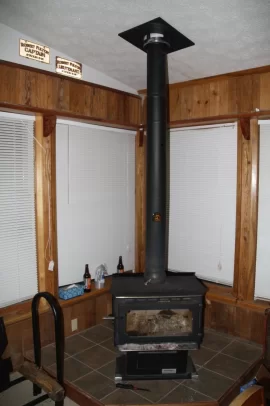

Evening all,

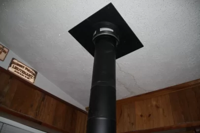

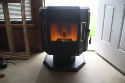

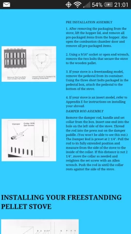

I haven't had time to give an update since outage season has started for me. In the pictures below you can see that I got everything painted and re assembled. I fired it up this past saturday and after a little adjusting it self ignited and had a nice active flame. But now the questions, Can i reset the damper to the factory setting? If so how? Next question, Do I have to use pellet stove piping to connect to my existing chimney or can I use single wall 28 gauge 3" stove piping? My current chimney setup is a selkirk verticle 6" double wall through my ceiling and 6" single wall connecting my stove to the double wall. Ill try to attach a photo of the current set up. Im having a hard time figuring out the safest cleanest way to get this hooked up. Selkirk doesn't seem to make a 3" to 6" double wall coupling to connect to the double wall connection. I hope this is making sense but ill try to better explain if I can later.
Kris

It looks to be an Advantage II-T. Open the hopper lid, there should be a decal under it with a model #. I have the same stove in an insert. There is a certain depth the collar on the damper is set at, I believe 2 1/4", but let me check mine first.
PS GREAT stove. I love mine.
Yes, 2 1/4". From the side of stove to inside of the collar. I'll attach a screen shot from my phone. [Hearth.com] Pellet newbie with a Whitfield full of questions.

Ouch. They stopped manufacturing the Advantage II-T in 2000. Is a great stove.
