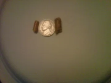

Below is email exchange about corn.. One skid had fatty pellets another where less than a 1/4".
I forwarded on your email to my plant manager in NC and he told me that
for a very brief period in 2010 we did make Freedom Fuel at a 7/32nd
diameter and then switched to 5/16th. He also said that if adjust the
combustion air on your stove a little you should get a better burn with
the smaller pellet.
As far as the corn there's a tiny fraction of the hundreds of thousands
of tons we produce each year may have trace amounts of corn in them as
industry standard practice denotes that corn be used to clear the wood
from the holes in the die whenever the pellet mills are shut down for
regular maintenance or emergency repair. Failure to do so will cause the
wood to plug the holes permanently rendering the $10k die useless.
Corn is far more expensive than wood and as such would never be used
as a filler in place of wood by any right minded wood pellet producer.
Furthermore corn burns virtually identical to wood and therefore will
not cause any adverse effects to a stove or exhaust system. I hope this
answers your questions and thank you for choosing Freedom Fuel this
season.

Subject: Freedom fuel diameter
Hi scott, thanks for taking my call.
Attached is an image of the pellets we discussed. The image depicts
pellets from 2 skids, both sacks labeled 7. 6437592365. 3
On a side note, the sacks indicate 100 percent wood. Why do the 5/16ths
pellets contain a fair amount of shelled corn?
