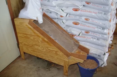

Made a pellet sifter today. Thought I would share with you guys. I'll grab another photo in the morning of the completed front.

Thanks for taking the time to post pics. Looks like a good weekend project.
Is there a slope on the bottom? If that's 1/4" hardware cloth on the bottom, you're going to need some finer window screening over it. I speak from experience.
[Hearth.com] Pellet Shifter DYI
There is a slope. It was actually a 3'x3' decorative aluminum covering that I found at Home Depot and cut to size.
Make sure the spacing is less than 1/4" or you'll have pellets hanging up in the openings or falling through.
