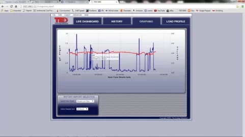

I have a whole house electrical monitoring system that it appears several people here could benefit from. It's called The Energy Detective (TED). I certainly don't endorse it because it has given me the fits over the years and I am banned from their forum because I questioned their support and design :) but it IS very accurate to within a dollar or two of my actual bill. You can see the occasional spikes as my water heater comes on. The other ones are my stove and heat pump (not running the pellet stoves).

Yes, it's hardware driven. You put current transformers around the two main input lines in your breaker box, hook up a transmitter to an open breaker, and plug a communication unit into an open outlet and run a wire back to your router. What I didn't like about the system is that they use house wiring for communicating with the main unit, which is super antiquated technology that lays itself open to all kinds of interference. I had a dimmer switch that caused interference and frustration until I found it. Why they don't use a wireless technology was beyond me, hence the banning when others agreed with me.
