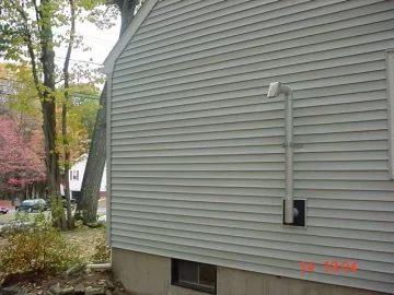

Why a minimum of 5 feet of vertical pipe? I was going to put 4 feet up. Can someone explain? Thanks guys and ladies
As far as i know 5' is the minimum they recommend to get a natural draft going to extract the burning pellets smoke if it shuts down unexpectedly. The stove pipe and thimble kits you buy are 5' as well. Remember, this pipe just twists together so you can add to it as needed.
this is what it should look like
The original posters pipe isn't going to look like that
because they claim to have it vented up a chimney. See post #3.
Question to anyone about the 5 foot vertical .... If you run 5 feet up and then go a foot or so horizontal, doesn't the fact that the run is then finished off with a
horizontal piece negate the vertical needed for draft? I thought the idea of a vertical pipe was so that the air moving across the vertical pipe causes the DRAFT??
So if you add a horizontal (plus a down-ward end cap) how can the air "pull" the exhaust gases up and out?

I don't think the horizontal bit at the top will effect it much. I am pretty sure the 5 feet of vertical pipe is just a number that seams to work good. I can't imagine anyone house filling up with smoke if they chamber is sealed well at the door gaskets and you have a warm pipe with some vertical section, the smoldering fire will still be hot and still want to rise.
I have had a bunch of power outages and not once Has my stove released a hint of smoke in the house. But I also have 6ft of vertical pipe.
If they have it vented up a chimney there should be no possibility of smoke entering the house unless its not fully sealed where the pipe enters the chimney.
But you got to remember that several makes of pellet stoves have the "AIRWASH" system,(or similar) which is basically a minimal "gap" at the door/glass gasket. And THAT is a spot that would be very prone for smoke to enter back into the house during a power outage.
