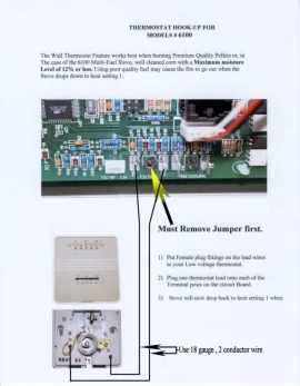

Which American harvest do you have 6041, 6039 4 button or 6039 three button? As it is a used stove the first thing I would check is if you have a thermostat clip installed. There should be a small metal clip inserted in your control board were it says tsat. The former owners might have had it hook to a external thermostat. This image says for a 6100 but is is the same for the American harvest. Should be a small metal clip were the yellow arrow points If no clip the stove will run on 1 no matter what you set it on. Is the dash blinking between the P and the 9 when you have it on 9? Unplug stove take off the left side panel and look at the back of your control board.
