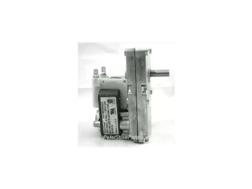

  • [Hearth.com] Pellet stove auger motor (cheap)

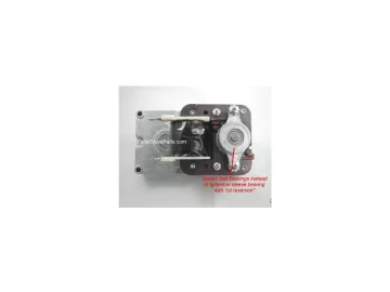

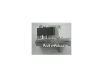

Which brand auger motors uses ball bearings?

So to clarify which brand of the motors/gear case has the ball bearings?

Gleason Avery has spherical bearings in the gearcase. Good prices too!
(broken link removed to http://www.gleasonavery.com/catalog/pellet-corn-stove-motors.html)
The eBay link that Gio posted above is for Ball Bearings on the Motor...Gleason is not...just a plain stock, low cost assembly same as mfg's.
The motor is the weak link in this assembly, and runs at a fixed speed...every auger motor runs at the same speed. Through the gears is where the output RPM is developed.
It is advantageous to have ball-bearings on this motor as opposed to the self-lubricating bronze sleeve...but stove mfg want to save cost to build thousands of stoves,

Looking at NEStoveOwners thread, https://www.hearth.com/talk/threads/34017/
It show the gleasen avery motor with sealed bearings. So does gleason have a typo on there site?
GEARCASE CONSTRUCTION
Gearcase: Zinc die cast
Lubrication: Grease filled
Gears: Hardened steel and phenolic
Bearings: Spherical
Mounting: All positions
Rotation: CW facing shaft
Shaft: 3/8" diameter x 1" long with flat, hardened
MOTOR CONSTRUCTION
Type: Shaded pole
Protection: Impedance or thermally protected
Hz: 60 or 50
Duty: Intermittent
Bearings: Self-lubricating bronze sleeve Is this right?????????
Insulation: Class B
UL and CSA
Motor Leads: 6" from bobbin
