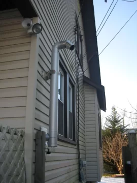

Exhaust pipe leaves the house approx 3 feet and has a little vent style cover at the end. Over time the siding has discolored and needs cleaning. To prevent this from happening again after cleaning, would a simple extension of the exhaust work ? Maybe another 2-3 feet away from the house wall.
Or, will this create other issues ?

something like this would do.
Thanks, thats even closer than the current situation though. Maybe the wind flow around the house needs to be explored.
That side of the house Faces a lake about 200 yards away with No house between us and the lake....
what I;m saying is we get Un-Obstructed wind towards the exhaust but no blackening of the house side.
