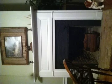

Ok so I got my p-stove, I have to run the pipe through the fireplace , it will not only look better, but I cannot altar home (historical scocitey) however I've herd from 10 different people 20 diff ways to do it . Some say I can't go over 20ft of pipe others say run 3ft, others say I must go the full 30ft to the top , and yet also to save money I e herd to go 3-5ft with the good triple wall then go with stainless flex to the top??? Omg maybe I should have went with wood stove?? Can someone who really knows , please tell me how to do this in somewhat of a cheap yet safe way!!
So you got a pellet insert? Using the same Chimney that used to vent the fireplace? is that correct?[/qu I bought a freestanding stove, the fire place is huge (200 ur old house) it will sit on the brick hearth and look great , but yes I want to run pipe through the chimmeney. It's a straight up brick 30ft from floor to top with a cover 9in over the top.

ok sounds great. I e tried to send a pic but it's not showing up? Anyway I will be on here 2morrow b4 330pm when my buckeyes play, and let u know how it goes !! And thank u guys so very much. And thank u for this site!! Wish me luck
