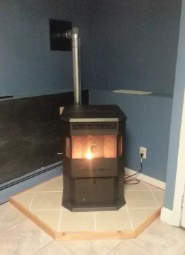

Thanks everyone. The initial responses to my post had me pretty worried but I have had my stove in for a week and my boiler hasn't come on once. I haven't installed the vent with the duct fan yet but I am sure that will only improve on what I already have. Not only have I not been burning any oil, but my house is much warmer than before. Used to keep the thermo on 64 to keep my oil costs down, now the main living area stays around 74. I am sure I am going to burn some oil once the temps get way down, but as long as I am reducing my oil consumption, its worth it. Here's a pic of my install:

Good job.
Prepare for surge protecter onslaught...
Already added the surge protector. Waiting for some parts I ordered online to finish up the venting. Will post pics when its done.
