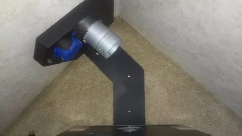

[Hearth.com] pellet stove install in a 32ft fithwheel [Hearth.com] pellet stove install in a 32ft fithwheel hi everyone. I would like to bust the myth that you can't install a pellet stove in a fithwheel. This is my install in progress. First off I know its not CODE to install in a RV. But everything does meet code on the inside. I am a full time RV lifestyle and the winter propane and electric was at about $1600 A winter. The stove is a Harman accentra $2800 new. Keep in mind that I am not on the road. You must add support under the slide out floor. The stove is 400lb loaded. I will try to load more pics soon. Not sure if all got on here .There will be a 3000 watt inverter install running off four 220 amp hrs 6volt deep cycle battery. And a honda 3000si generator for the long term outages. I will post another thread when it gets cool enough to fire it up. If you don't here from me that means things didn't go so good. [Hearth.com] pellet stove install in a 32ft fithwheel[Hearth.com] pellet stove install in a 32ft fithwheel [Hearth.com] pellet stove install in a 32ft fithwheel[Hearth.com] pellet stove install in a 32ft fithwheel [Hearth.com] pellet stove install in a 32ft fithwheel[Hearth.com] pellet stove install in a 32ft fithwheel

Just my $0.02 worth, you might want to put a bit of downward angle on the end of the vent to help keep water out.

Take those slide supports out. Remember, that slide was built to support a couch and two or three adults sitting on it. A 400# stove is well within that range. None of the RV manufacturers recommend supporting the slideouts since what can happen is the rest of the trailer can (will) move and then the slide is supporting the trailer. You're better off without that mess. A proper hearth pad will help distribute the load of the stove over a larger area.
I think it looks great. Also think there is no reason that you couldn't bolt the stove down provided that you can run those bolts down into the bottom of the slide without hitting support members. I would use carriage bolts installed upwards from below so the smooth heads will slide in nicely.

OK, I ain't a pellet stove wizard but since when is carpet a "non-combustible surface" under a pellet stove?
Edit: Never mind. Guessing it is sitting on the Harmon cast iron floor protector.
