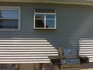

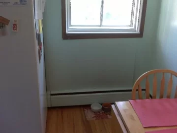

Ok, so I took some pictures of the install space. I am finally updating the kitchen as well, so I will be removing the wonderful paneling :) But as you can see the stove will go right under the window. Fits perfect in that area. Now my question is this, the pipe is going to come out the back of the stove and go directly through the wall to the back of the house. When it comes out the back of the house it will be about 4.5 feet off the ground. Can I just install the cap right there and I would be good to go or do I have to come up a little bit then cap? From this link:
http://www.daviddarling.info/encyclopedia/P/AE_pellet_stove_installation.html
It seems like Figure 2 is what I want to do...
Any thoughts?

You can run the pipe horizontally, but you'll need to screw the window shut so it's no longer a functioning window. This is to meet code and for safety purposes. Make sure the pipe has a slight rise in it for some draft effect. Many other folks on this forum have run their pipe horizontally without any issues.

Hey rap, i started another question about installing straight out but figured I would ask you. The chimney kit I bought says something about the pipe having to be at least 4 feet below the window. Do you know if that means a functioning window or not? Because you mentioned screwing the window shut to pass code. Just wanted to check on that. I am waiting to hear back from the inspector, left a message with him today...
I'm not sure if that will in fact pass code, it truly depends on the inspector's mood that day. If the window is sealed and can't be opened then is it still a window? You may want to wait to hear back from your inspector before cutting a hole in your house that you can't use.
If he says no , then you could always go with the 4" vent, come out below the window and use a 90 to direct it away from the window and then use straight pipes to get your 48" away. This won't look pretty, but it'll pass code.

Installing near window will be easy but what was that next to the area of the stove? fridge?? hmmm not sure if I would be so close to that. Try and insert ?? with small fans to move the air ( we have one small one mounted to push it towards the back of home.
