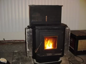

Finally got the heater covers put together and mounted. Added insulation on the inside and I hope this will raise the temp on the water a few more degrees. The reflection on top of the stove is from the mirrored tape around the sight glass.
  • [Hearth.com] Pellet stove modifications
That is some wild lookin stove Birdman. The guys at Englander never dreamed of such a thing.......LOL.
Keep us up-to-date on the performance.
macman said:
That is some wild lo stove Birdman. The guys at Englander never dreamed of such a thing.......LOL.
I could not have done any of this without permission from the guys at Englander. I did not want to void my warranty because the stove is only a few months old. I emailed them each time to make sure I was OK before I put anything on. I think I am their secret r&d department. You do have to admit they not only make a great stove but anyone else would have voided my warranty for even asking. Will post my readings in a couple days to let you know how I make out.
