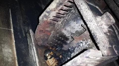

Here's a picture of recommended pellet tray setup. It has the larger holes. I would look up and install the room sensor too. Now there has been a upgrade kit for the stove and a slight change of the dip switches too.
Good luck
  • [Hearth.com] Pellet stove question from a newbie to pellet stoves

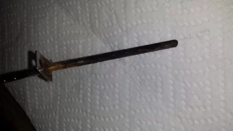

Wow. That burnpot has seen some use, & the ESP is DEFINITELY in need of a good cleaning.
If you're planning on burning only wood pellets, you may want to get the other burnpot..
While you're at it, I'd also grab an ESP & an igniter. No telling how long those parts have been in there...
That appears to be the correct burn tray for pellets just not the open end. The corn tray has very small holes so as not to cool the fire down with air as corn ignites at a couple hundred degrees more than wood pellets. The ESP does not look happy. You can always hone your skills at manual ignition:) Our stove only get a dozen or so starts a year.
Something we have forgot to ask and you have not volunteered is how well it has recently been cleaned as a dirty stove and its venting can be a big problem in not letting the stove breath and can cause the stove to not stay on a high fire. Seeing the ESP and the stoves weldment on the back of the firepot it probably really needs a drag out and blowout cleaning of the entire system.

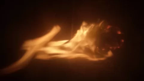

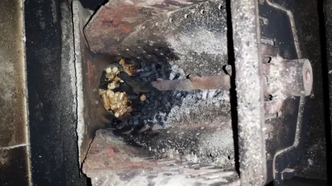

Ok...before seeing your replies, I started the stove up (I cleaned the burnpot with a wire brush yesterday so it must be that bad lol). The igniter lights the fire fine-I actually threw a handful of pellets in before lighting it to help it out. That helped at first. The fire lit, it got going good, then the distribution blower kicked on. It put out heat for about 10-15 minutes then the distribution blower shut off. I came in to inspect and there's hardly any fuel in the burnpot.
