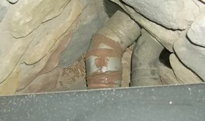

Today, as I continued my replacement of the flue with new, I took note of the sealant I used in 1992 to seal the joints for the various sections (the parts you twist to adjust it) of an adjustable elbow between the flue pipe and stove, all orange RTV and still soft. I had smeared it on the exterior of the joints only. It is the hottest place along the vent, pardon the dusty stuff, it's all clean now.
Only other place I used it was outside where the pipe enters the wall thimble-passthrough. I did see my thimble is also insulated some with white fluffy stuff.
