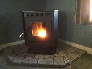

I use these settings to allow for a clean burn, some pellets just burn 'dirty' and I've found away to adjust these settings so that the glass does not get black / cloudy.
I get a nice clean blue / white flame all the time now with the stove in the upper 370 - 450F temps.
