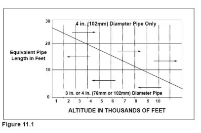

If I remember right, our Quad 1200i had a chart for when to change to 4". It is a linear graph with flue length decreasing with altitude. I'll have to look it up, but I think it switched to 4" at sea level at something like 25'. FWIW, our stack was 21' on 3" and it worked great. No issues at all. But that was a direct connect, no elbows involved.
Here's the chart for the Mt. Vernon.
  • [Hearth.com] Pellet Stove Venting?
Also there is a table that goes with the chart, 1ft of vertical = 0.5ft equivalent feet. That's where I got the 50' thing.
