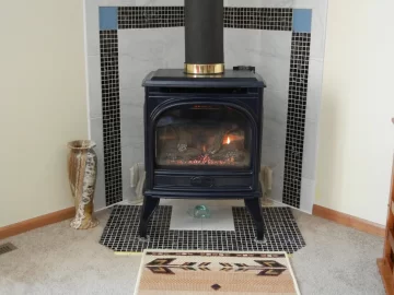

We had to install a secondary heat source to qualify for off peak electricity. Picked up the stove and everything for install but the siding standoff for around $300. Alladin-Dovre 300DV Used as a backup if no electricity. Used now only for Christmas and New years ambiance.
  • [Hearth.com] Pellet Stove versus Propane Room Heater
