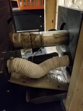

I've got a PP130 in my workshop and am very happy with it...this is what the OAK looks like when its drawing -31c air (yup cold this morning...the water line (insulated and buried a couple ft) to the lake (with a heat trace line in it froze for a few hours) :|
anyway if it gets cold you'll have to deal with the moisture off that pipe...I have a cake pan under it..it collects the water when the ice melts (in July) and it evaporates..
