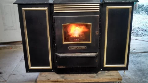

Hi guys,
Just picked up this stove and am having trouble with the circuit board I think. Light blinks and changes flash rate when tstat is jumpered but auger runs continuously. Any ideas on this? Anybody know anyone who could repair this piece of history? LOL. Its an old shool stylish stove and deserves to be repaired,,,, Thanks, Tim

which one?
Have you ruled out limit switch?
Low limit disc. Failing that, control board can be repaired sometimes ... should be able to find the threads with repair services with a search. This fellow repairs Whitfields but he may be able to help with this! (broken link removed to http://www.kijiji.ca/v-heater-humidifier-dehumidifier/peterborough/whitfield-advantage-ii-t-iii-plus-control-board-repair-service/265783976)
Keep us posted ...
