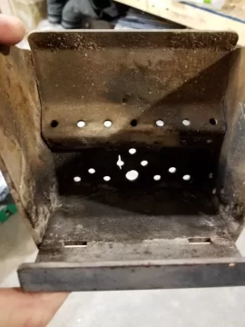

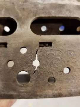

Is this a problem? If so can I weld it (I've got a Lincoln WeldPac 100 MIG) or does it need to be replaced?
Thanks [Hearth.com] PelPro 130, Found a crack in firepot [Hearth.com] PelPro 130, Found a crack in firepot
I’d weld the bottom of it. Done the old Breckwell till i had beads around all the holes lol
Reactions: kenora
I'll weld er up tomorrow :)
