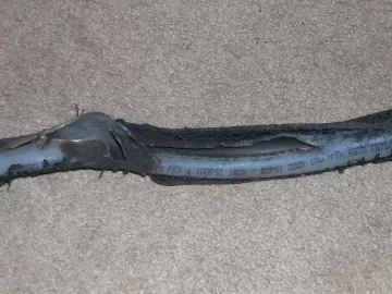

I woke up 12:00 on Sunday night to the sound of my smoke detectors going off and the sound of water and steam gushing. Went and opened my basement door and was overwhelmed with steam and couldn't see a darn thing. I grabbed a flashlight and headed down to the boiler the temp gauge was maxed out and pressure was at 0. I shut the primary and secondary air to slow down the burn. I found the pex that ran above my flue pipe had exploded and that's where the steam and water was leaking from. I isolated that zone and then confirmed that there was still some water in the boiler. I manually opened the relief valve and pulled out a pipe plug just to be safe. The boiler was still making steam because there was no pressure. I started to fill it back up real slow because I didn't want to temp shock the steel. Meanwhile my wife is running around vacuming and mopping up the boiler water that had gone into several basement rooms. After about 1/2 hr the boiler was full again cooled off and holding pressure. I Checked the fire and it was still going but now just a bed of coals. We finished cleaning up for the night and let the boiler run in oil mode. So I guess you never want PEX above the flu pipe even if it was 20" above it's still not enough under certain conditions.

Sounds like a real mess - glad no one was hurt. That PEX looks like it's burned - is that what happened? I'm curious about how and why it failed, and what precautions might be indicated. I would have assumed that 20" was plenty of clearance above a flue pipe unless something really unusual is going on. What was your pressure relief set at?

What kind of pex is that? It looks like some type of alumi-pex....
That does look a little charred. Is it possible that it drooped down when it got hot?
Keep in mind that PEX is still plastic and its burst pressure goes down quickly with temperature. If it was carrying 180F water and the ceiling was 120 and the radiant heat from the stack was warming it up, you might have had the perfect storm. Obviously time for a little redesign... :smirk:

DAM you should have put a disclaimer on your thread title VERY GRAPHIC may upset the stomach of boiler owners, you were lucky to be home when this went down (although I am sure you felt anything but lucky)..Sorry for my rudeness Welcome to the boiler room very dramatic second thread, In my opinion 180 degree pressurized water going through that pex is boarderline to begin with must be the small amount of heat that the chimney produced was enough to burst that line..We all feel for you and hate to hear another fellow boiler operator had to experience those conditions I am glad you posted you may save somebody from running their pex anywhere near the chimney I would think 20" would be ok but I guess not..Good luck with the repair..Dave

Look's like it burned through from the outside in. I would guess that a combination of high water temp and proximity to the flue pipe caused that failure. Pex will become very pliable at higher temps and I often see it installed with inadequate support. I would guess that possibly you had an over temp or a no flow situation which caused the pex to sag onto or very near the flue pipe. The surface temp of that was probably what caused the rupture. Almost any size pex should be supported every 2-3' at 180*+ temps otherwise it turns into spaghetti.
I think REDOX nailed it when he said it drooped when it got hot and the end result was a lot closer than 20"..
Was the pex free floating over the chimney? If so get ready Mr George Clooney here comes the storm..Dave
I tend to agree with the above posts. It sure looks like it made contact with your flue. The black charring wouldn't have been cause by hot water alone...

The pex was 3/4" Wirsbo HE pex, it may look a little funny because there was black foam insulation on it which melted to it. The pipe was not touching the flue and was still at regular height when I got to it. I may be possible that it droped when hot and then raised back up when the leak started. It could have had a scratch in it but i'll never know now. Anyway I will only use copper in a location like that from now on and then switch back to pex after the heat danger. I think I'm going to add extra heat sheilds over the flue also just in case.

If that is indeed the case, it would seem that you had a severe over temp situation for some reason. HE pex is rated 80psi@200* so I would surmise that your temp was somewhat higher than that. Once any pex gets above 220* or so the pressure it will sustain diminishes rapidly. Is it possible that your system stagnated (No flow) for even a few minutes?
