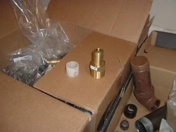

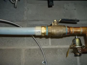

On my boiler install I used 1-1/4" hepex and logstor for the shed to house run. When i went to buy fittings I was shocked at the prices so I started searching around and found what I needed at Lowes of all places. These fittings still aren't cheap at 16 bucks a piece but a lot cheaper then others I looked at. These fittings , transition my 1-1/4 pex to 1-1/4" black pipe and/or copper. I used expander rings to secure them but I have seen where some guys on this site used hose clamps to secure them.

I used fitting like those to transition from 1 1/4 to smaller also. Got them at centel boiler dealer for $16 each. I used two hose clamps on each fitting. Been installed for 5 years with no problems.
My logstor to copper connections I used the compression fittings that are used with alum apex. Five years so far and no problems.
