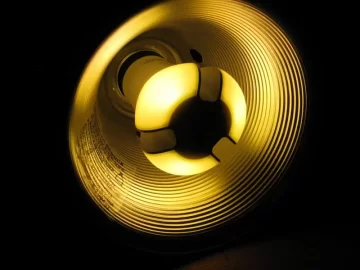

Some of you might remember last year I reported trying out LED based down lights (Ecosmart/Cree CR6s and Ecosmart/Lighting Science PAR30 bulbs) when I was replacing all the can lights in my kitchen and dining room last year as part of an insulation/efficiency upgrade. Well a year later and I am very happy with the performance and light output of those units… soooo much better than CFL … that I decided to try out some more LEDs.
Presenting the (broken link removed)!
[Hearth.com] Philips L-Prize lamp​
I have a couple of fixtures where CFLs burn out often (bath) and the local electric company offers the Philips L-Prize bulb at a subsides price of $25 so I decided to try a couple.
My overall impression…. This is a VERY nice bulb. Brighter than CFL…maybe brighter than incandescent, minimal eyestrain, extremely low power consumption. The power savings is better than reported and in fact this bulb measured a 40% improvement even versus an equivalent CFL!
Even at the discounted $25 price it’s a bit of a luxury but I’d say worth it at this time for closed fixtures that get a lot of run time and eat CFLs, or maybe one or two around the house in your favorite reading lamp. I wouldn't shell out the full $49 for one.

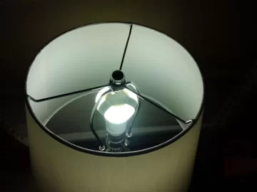

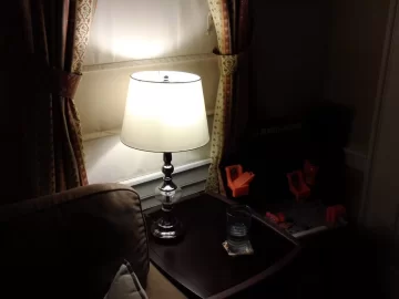

For now I put in 3 – one in the bath vanity, and two in the table lamps in our den that get more use than any other lamp in the house. This is where I sit and read in the evening.
[Hearth.com] Philips L-Prize lamp [Hearth.com] Philips L-Prize lamp​
When the price comes under $10 I will seriously think about starting to swap them out around the house. The only question at this point is will something even better come along before these hit break even?

First impressions: The bulb is a LOT brighter than the 13watt CFL we had in the same lamp. In fact it feels like going up a size. My wife’s first impression was “wow that’s bright” but after a day we really like the improved lighting, seems like the room was too dim before.
I am surprised thy omitted the big heat sink from the base, as it still gets quite hot… Not as hot as an incandescent obviously but still too hot to touch comfortably, I measured 127F on the white base with a cheap IR thermometer after an hour of run time.

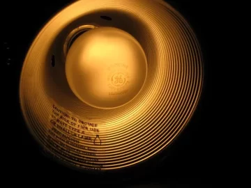

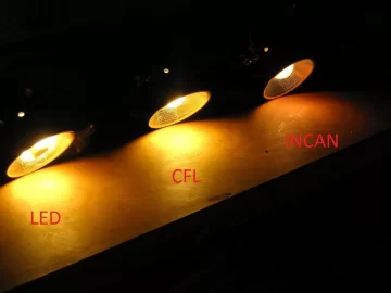

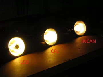

To give you an idea of the relative brightness here are side by side shots of 3 roughly equivalent lamps – the L-Prize LED, a 13watt CFL and a 60watt incandescent (this one is a rough service bulb, it was all I had). All 3 bulbs are hooked up to the same power strip, and warmed up for 5 minutes. The voltage in my house is not great - fluctuating around 110-113vac at time of test.
Now looking at each lamp. I tested each on a kil-a-watt after a short (3-5 min) warmup.
Incandescent: GE 60 watt rough service (Hungary) $ a buck?
Rated at 60 watts, 500 lumens and 2000hours @ 130v (or 380 lumens & 5400h @ 120v)
Hooked up to a kil-a-watt I measured
· 46watt/46VA
· PF = 1.0 (expected)
· @ 113.7vac

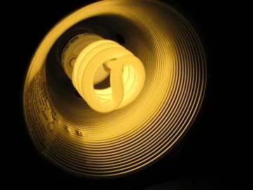

CFL: Westpointe 13 watt “60 watt equivalent” (China) $3
Rated at 13 watts, 900 lumens, ? CRI, 2700k color temperature and 12,000 hours
Measured:
· 12watt / 20VA
· PF = 0.58
· @ 112.2vac
LED: (broken link removed) (USA) $35-50 on amazon or $25 subsidized
Rated at 9.5 watts, 940 lumens, 92 CRI, 2700k color temperature and 25,000 hour
Measured:
· 7watt / 8VA
· PF = 0.85
· @ 110.0vac
