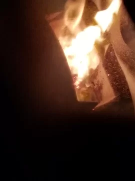

4th day ran it 48 hours no cleaning same result, nice hot flame. Good burn. The spongy stuff is staying away preventing those build ups that give you a lazy flame
I am reporting a while Later to say that the grate cleaning times made a huge improvement. I tried also to increase the rpm of my sabrina on P1 power level 1 I think its p18 in the settings ... to 2100 or 2050 I cant remember ...rpm . I think the default is 1850. I have noticed the pot is very clean looking and the pellets hover at or around the hole where the ignitor starts it up. This was after 24 hours running. This means that the pellets are burning more efficiently and not piling up allowing more cool air to come into the holes below the pot from my outside air kit. So increase the grate cleaning time and the rpm of power level 1 is very good. Remember when your power level is set to p3 or higher once it reaches the desired temp , it will operate in P1 even though the screen will say P3 .... it will just say P3 OK instead. This is why it's good to increase P1 rpm because my stove operates most of the time on that mode, so why on earth would I want a rpm that is too low.
Picture of the pot.. notice the hole and the pellets burning nice and hot. Flame is very nice and not lazy at all.

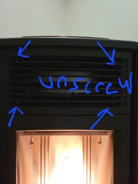

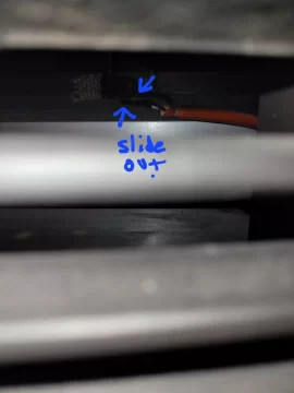

Unscrew the four grate screws. Carefully not to drop them inside. Pull the grade out. Reach in back un plug the switch take picture first so you know which wire goes where. Use a small wrench or hand to untighten the nut and slide the switch out. Replace with new one. Done.

The ignitor involved removing the top grate... 4 screws... Opening the door and removing the 2 screws beneath it to remove the bottom cover...then you fan access the screws on the right cover to renove the right cover. They have some in front on the side and a few in back. On the ones in back i just loosened them. And the ones in front i removed. Pop and slide the right cover off. And slide it back in after. That will allow you to access the ignitor. It fits inside a metal tube and you need a small adjustable wrench. Unplug it from the board, unscrew, pull out, put back new one. Remember where the plug goes into. Take a pic.

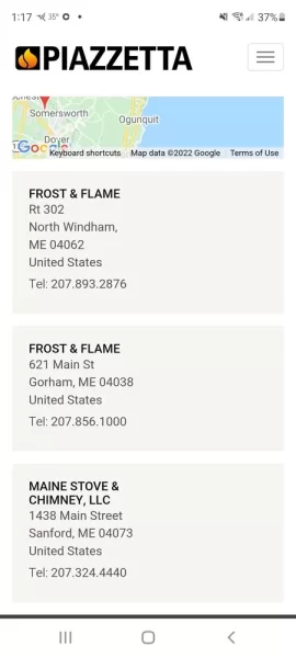

Thank you for these options, I typically use Frost & Flame, but they rarely call back and it's a challenge to get an apt. I called Maine Stove & Chimney and have an apt. for a look and possibly to install a new fan. Reason is it makes a fair amount of noise and I'm concerned it will just die in the dead of winter, so want to beat it to the punch. I'm ordering the igniter and the hopper switch and will install, seems pretty straightforward? Feel free to share any other tips you have for either and thank so much!
