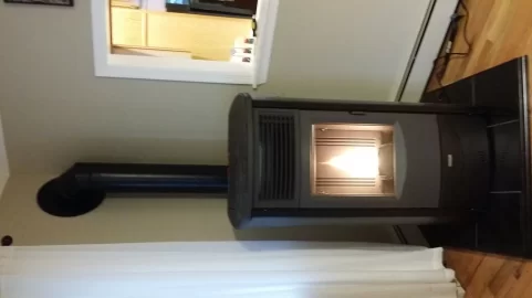

I'm on a breezy lake here in Maine, and between the lake and the ceiling fans, I'm trying to avoid AC.
Sadly, I don't have any pics of the install, other than the pic in my avatar of it being fired up for the first time. After you build a large house, you become a little jaded about documenting every thing that you do! Maybe not jaded, more like tired. The stove seemed like such a simple install, I was done before I knew it! Thanks for the offer of the manual, I'll send you my email address pronto.

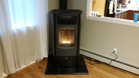

Up and running. [Hearth.com] Piazzetta mode choices...
  • [Hearth.com] Piazzetta mode choices...
