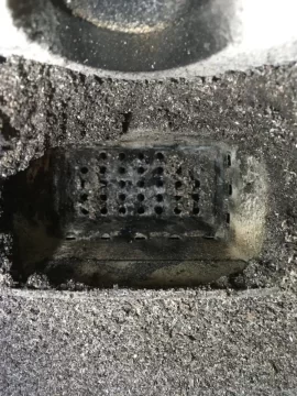

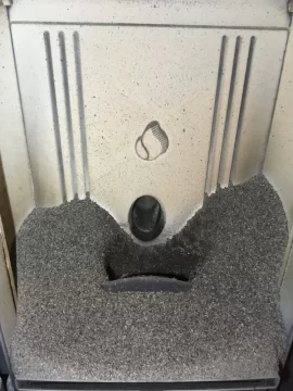

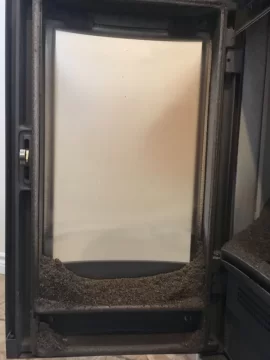

Well the reason why there is a p10 and p22 programming line in your parameter menu is very simple; The Monia and Sabrina have the same Mother board so dose the P95... and P96... and yes if you do have a bootloader and the correct firmware you will be capable to ( unlock it ) putting the Sabrina in a Monia and a P96... in a P95... and get dose value to run on your stove but there is no reason to do so, in the Monia or P95... witch are the same stove beside the fact that you can conduct the air in a duck, they have the same heat chamber configuration. power level P4 and P3 should be good to heat up the house witch should be around 1800 square feet. if you need more info you can send me an e-mail at pmaertens@msn.com my pleasure ! the important ting about your stove is not the amount of power level setting but it's to be set so that you don't have any soot and that you never have to clean your burn put ! have a look to the pictures below.
