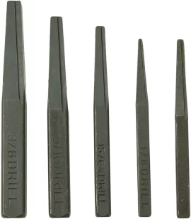

6mm you can take it out with ... I dont know the name of that tool in English need to drill a hole first and then turn counter clock

Thanks. Got the screw out. Problem now is it was so seized up it damaged the threads of the stove and I can’t get a new screw to thread in.
