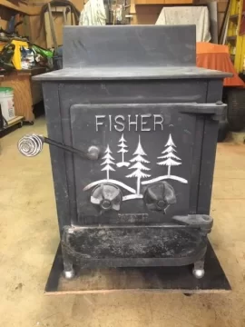

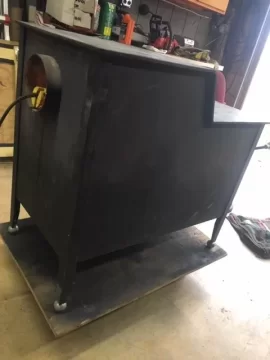

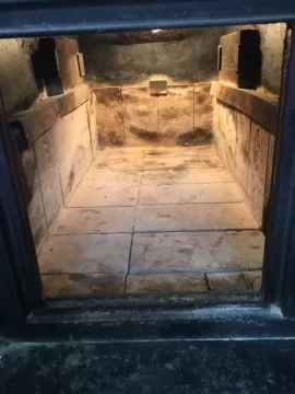

Bought this Papa Bear the other day. Seems in good shape, needs paint and 1 brick replaced.
It was only 20 minutes from my house. A rehab outfit was redoing a house and wanted it out, I paid beer money for it and the workers loaded it on my trailer for me.

Nice find! I wish I could get that lucky.

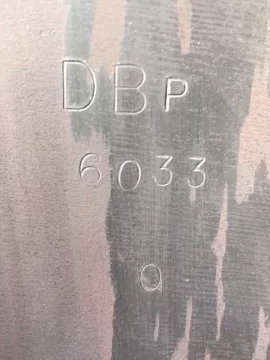

Did a little work on the new Papa bear today and found this marking. It appears to be a Dunn Brothers stove.

I've never seen a Dunn Brothers stove before. Is there any welded markings on it?
No other welding marks, I'm assuming DB is Dunn Brothers. I know Dunn made stoves for the VA and WV area. This stove was bought in northeastern Maryland.

Northeast MD might as well be VA, so not too surprising

At the Fisher Stove national convention in the spring of 1977 the Dunn Brothers received a large silver trophy for selling the most stoves. There's probably a good chance of finding a DB stove in any of the states that surround VA and WV.

No doubt these stoves traveled, sometimes great distances. Ask any of our Northeast collectors about shipping stoves cross country.
Coaly, can you tell me where Dunn Brothers was located and if the DB initials do actually indicate this is one of their stoves?

I found this post from 2013 from coaly that might answer your question;
Here's a 1977 dealers list giving the Virginia address;
[Hearth.com] Picked up a Papa Bear
Google Map; 1129 Florida Street, Salem, VA for a decent street view.
In 1979 it became E&W Machine as it remains today; (broken link removed)
I assume the Dunns went on to expand like many others to larger fabricating facilities.
Looks fantastic Don! What are your plans for it? Did you replace or remove the firebricks?
I pulled all brick, replaced 1 broken and a missing brick. I like to pull them and and check underneath for rust. I'll flip them over if they're nicer looking on the opposite side. Here's what it looked like without the brick.

I haven't had much luck removing firebricks without breaking the bricks, so I end up removing all of the bricks. The few bricks that come out whole, I set aside for other uses. I leave the firebricks out of my stoves until I decide to use them. I use all new bricks when I replace them. My collector stoves have no bricks in them, and since I am a collector I don't sell any of my stoves.

Todd removing bricks can be a pain. If there's broken ones on the floor I start there breaking out the brick. I use a flat pry bar and rubber hammer to get them out. I also use a thin putty knife and vacuum to get the ash out from between the bricks. That ash locks them in tight. I also have a homemade table saw made from an old circular saw screwed to a piece of plywood with masonry blade to cut bricks.
