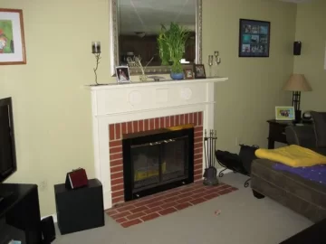

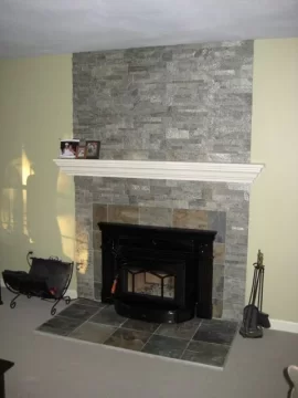

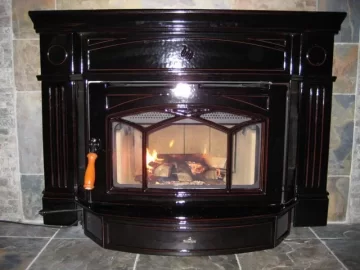

Well, after much help from this forum check out my new install. :)
You can see my old hearth, the 40 foot ladder/ 35 foot liner, the new hearth and insert and the first fire....
How satisfying!
Thanks for all the help and encouragement, I hope I can return the favor to future members!

that is one long liner! I only had to put in a 20ft liner.
the surround and hearth extension came out great, very up to date looking. nice insert too.
did you fire it up yet?

Thanks! I guess the break in fire was so small you can't even see it in the last picture. LOL
Sweet! I really like the new look over the old look. The colors in the tile blend very nice with the Timberline Brown. Did you have to remove all the previous brick or did you go right over it?

We went right over it. It is a masonry fireplace so we did not want to damage any of it. Removed the mantel and they went over it.
I am very happy with it and have more than enough clearance now.
Oh!!!! This Hampton insert is the prettiest stove I've ever seen. I'll never forget the first time I saw one of these. It was love at first sight.
I want to know if it operates as well as it looks!!
Operates?! I don't want to get it dirty by burning in it! :)
I am just doing my break ins right now....hopefully by next week I will be able to open her up a little. From others here it performs quite well, so I am looking forward to it.
Had the second fire today, got it not quite 1/2 full. No smell, I wonder if it is because they put the insulation behind the faceplates....or maybe I am not getting it hot enough... We shall see tomorrow!

Hmmm, I don't have the enamal finish so I'm wondering if you will smell the paint cure. Maybe it's done at the factory for the enamal finish...

That could be.... I got it hot enough for the blower to come on auto low yesterday....can't wait to start a nice fire tonight.

Nice looking insert. That surround really adds to the look. The stonework came out great too.
