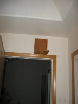

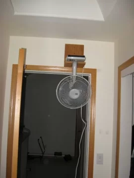

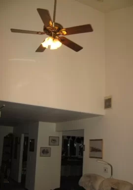

Hey guys and gals. Im looking for pics of how to all circulate the heat from one room to the next.
Here's my system. The ceiling fan pulls the hot air away from the apex of the cathedral ceiling, then the wall fan pumps it into a stairway to the upstairs. The door fan then pulls it into the master bedroom. We rarely use the door fan.
The system works OK when it's 78 degrees in the living room and 58 upstairs. Not much gets into the bedroom.

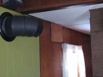

My wood stove is in the sun room behind the green wall. I installed an 8" duct fan (with dimmer switch) in the wall and a 90º swivel elbow that shoots the heat back the hall to the bedrooms an bath. No other heat is needed : )

Now that's cool

Nice ! I thought about doing this too. My porch with the stove can be vented like this to heat my upstairs. ;-)
