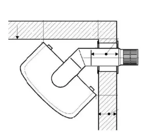

Those sure are pretty but I should have specified. I meant any freestanding stove. Typically you see a stove with either a 90 going straight out or just going straight up. In a corner you couldn't go directly back and out, you'd have to pick one side wall or the other and I'm wondering if that would look very weird.
So you're saying 45 into a 45 to the wall at some point? Could you pull the stove out enough to make it go up 90 elbow and straight into the thimble? May look a bit better. I think if you had some straight runs up and over it would look better than angles. Tough call, but I see where you are in terms of looks odd (just from mental pictures).

Is this what you are thinking of? I, personally, think it would look fine.

Yes exactly, thanks. A separate issue, unfortunately is on the corner you have pictured is a bunch of electrical non-sense, and the other corner is the front of our house. Hmmmmmmmmmmmmm.
Heat & Glo and Quadrafire units you can get a decorative cover for the cap that can be painted any color. If you pick a stove that uses Simpson duravent they just came out with some really cool decorative caps, copper and stainless steel ones as well. That would be an option to put it on the front of the house.
