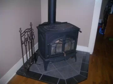

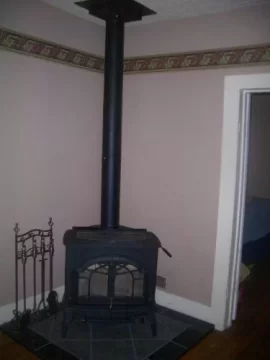

Just thought that i would show you guys some pictures of my new stove installed.

Very nice looking Install. It looks close to the walls. What are the clearances?
I thought the same thing - Wow, that's pretty close. Is that single wall pipe? Perhaps it's just the angle of the shot. Nice looking unit BTW!
I am not sure of the clearances the stove shop did the install for me. The corners of the stove is 7" from the wall and the pipe is 13" from the wall. I just measured them. Like i said they did the install so it should be right. it must be double wall according to the label on the back of the stove with double wall the corner has to be 6" from the wall and the pipe has to be 12" from the wall. I don't know for sure i am new at this.
Kelly
Very nice looking Kelly. Enjoy.
Kelly
You are on the money with those numbers. When my Isle Royal was installed, the first thing I did was get the tape measure out. I too, thought it was a little close, but the guessing stick in my hand said otherwise. You will love that stove. Mine is on the 5th year this upcoming season (I think). Has done a great job in every respect.
