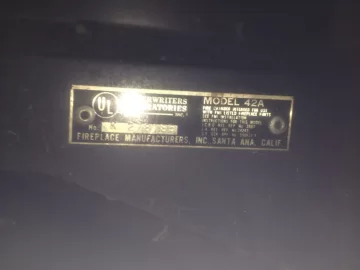

Have you thought about putting an insert in your prefab fireplace? Some inserts are approved for that. If you post the model and maybe some pictures people here may be able to tell you whether that is possible. Would certainly be much cheaper and less work than your plan.
We have thought about an insert but thought with the age of the house and the prefab ( 20 years) it wouldn't be wise. But I will start another thread with pics to see if it is a viable option. Thanks!

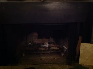

Ok so here are some pictures
Do we wreck it out and make an alcove with a new chimney or is there an insert that will fit this?

What's the measurements of the opening?

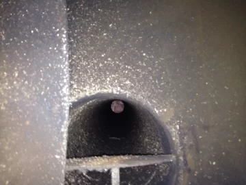

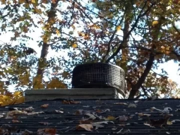

Whats the chimney set up? Is it a pre fab FP, or masonary?
Pics of the chimney looking up/down would help.

Opening is angled but the mouth of the opening is 35.5 wide and 19.5 deep 18.5 tall
I will get pics of chimney in the morning.

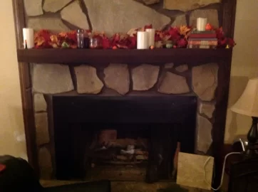

More pictures of inside and outside and top, and one fun one without flash lol

Wanted to bump this, hoping for some advice!! My house is about 1200 sq feet top level ranch style with kitchen great room on one end and bedrooms down hall over garage. 3 br 2 bath.with full basement.
Did those bricks come out from the back of the fireplace? The outside looks nice but the firebox seems to be in a rough shape. You may need to get a pro to see if it is even still suitable to have an insert put in. http://www.csia.org/search
Maybe your idea with ripping it out completely is not that bad. Another option would be to put an efficient zero clearance fireplace in there like the Napoleon NZ3000, KozyHeat 42 or Osburn Stratford. You could keep the nice look of a fireplace but still heat your house with that unit. May be less work than getting rid off it completely.
Yah the bricks cracked and fell, hence the need to decide what we are going to do. If we decide to do the alcove does the chimmineychase need to be opened to the ceiling?
