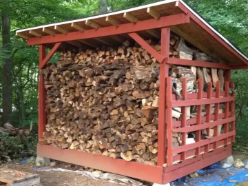

I use the deck blocks. About 5 years now and no issues. [Hearth.com] Piers for a wood shed
