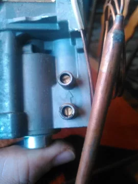

I'm not one to throw parts at a problem, hoping to hit the right one. First, on the SIT630 gas valve, be sure the thermostat is turned all the way up. When turning the knob, there should be a point, when the thermostat calls for heat, you will hear a slight click and you can feel the valve open. The 630 valve also has 2 test ports. One to test inlet pressure and one to test manifold pressure. I would make sure I have pressure at the inlet. Just because you hear the 530 solenoid click, don't assume it is opening.

These are the test ports I spoke of. The lower is inlet pressure. Upper is manifold pressure. The screw is only to be loosened, not removed. The inlet side will be charged if the solenoid is open. The manifold only when the valve opens.
