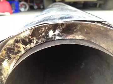

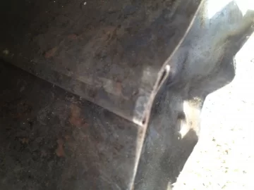

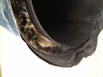

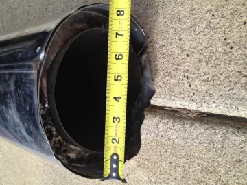

Hello, last year was my first year in our new house which came with a hearthstone II. I just got the parts to rebuild it from 30+years of use. I was attempting to take off the chimney cap this spring (in a battle to keep birds out) and the top stick of pipe came off and got all bent up. Im having a hard time identifying the pipe. I tried super vent, dura vent and Simpson. I then got some Selkirk sure temp at the recommendation of an old timer at Selkirk . It goes on and twists and feels secure but if you rock it back and forth it will come off.
[Hearth.com] Pipe identification new-please help [Hearth.com] Pipe identification new-please help
The old pipe has no fasteners or locking bands and the new pipe came with a locking band (which has nothing to attach to on the older pipe). Can anyone Id my old pipe or tell me how to secure the new sure temp to the old pipe.

I think it's security chimney. It has no ribs on the outside of the joint, just a smooth transition. I think it was originally riveted together, just use some self tapping SS screws.

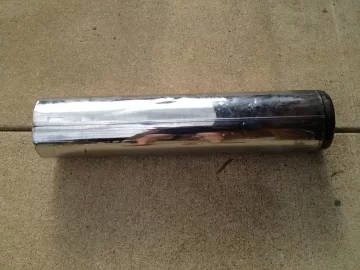

Thanks Webby. It also is marked made in Canada on the edge of male side. You are correct that there is no rib or bump on the female side. So security is a brand? Is it odd that the sure-temp fits on there...kind of? I'm new to the fire game so take it easy on me :)

Security is still around, I'm not sure it's the same though. If the other pipe is a nice fit and its outside of the house, screw it on there.
Just make sure to put the screws above the joint a half inch or so, they won't hit anything on the bottom side of the joint.
Ok... The sure temp goes on snugly but just doesn't really lock (which would be taken care of by the screws). As long Is there is not a concern of me turning my house into a pile of ashes it sounds good to me... Lol

Made in Canada might indicate that it's ICC Excel Class A. Just sayin.
Thanks for the replys. The chimney is twenty years old and is in excellent shape. I was attempting to take the top stick and cap off to figure out how to bird proof it. (After we quit having fires last season I was getting a bird a day in the stove). My fat fingers led to it nose diving off the roof. Security confirmed it is an older version of their ahst pipe. Thanks to webby for the suggestion.
