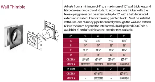

I don't see that Duravent makes a Dura tech through the wall thimble.
Does that mean I'm going to have to go Duraplus triple wall for the whole exterior?
Here is the DuraTech wall thimble info from their catalog
