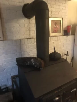

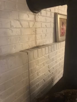

Hello There,
This wood stove came with our house (I'm not sure how old it is) it was inspected and repaired 3 years ago when we bought the house (a few cracked firebricks replaced). We have it cleaned each year, after the most recent spring cleaning we noticed the pipe dripping, it happens when it rains and when the wood stove is not being used. Why would this happen?

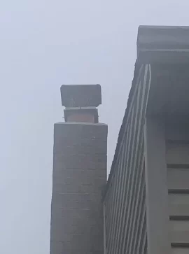

If the wind is blowing at the right angle while it is raining you can get rain down the chimney and it has to go somewhere. Maybe try a different chimney cap. What kind of chimney is it?
I think you're right! We realized last night it tends to happen when have major thunder storms and wind. It has a metal cap with a metal grate around the sides. I'm not sure if the chimney needs to be fixed or the pipe attached to the inside wall needs to be fixed to stop it form leaking down the wall?
