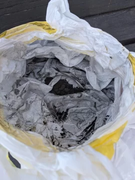

As an aside now that I can get the bag off, this is what I got from sweeping the chimney after 3 years of burning.
[Hearth.com] Pipe stuck while cleaning. Will not budge.
Reactions: bigealta
Looks good!
Reactions: wendell
Looks good!
Thanks!
I only had a tablespoon after the first year so I waited 3 this time. Wondering if I should go for 10 this time. LOL
