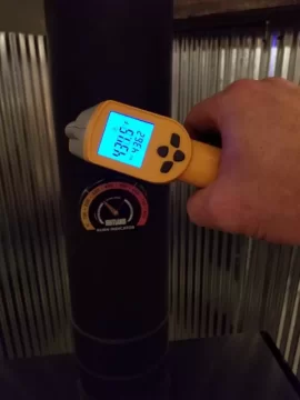

got the magnetic one and it's a big difference in my ir gun and the stove pipe thermometer [Hearth.com] pipe temps 2.

I believe my common sense has a better reading than the rutledge...

I had the very same result. Bought a different brand of magnetic. Will see if its any better hopefully soon.
You do realize cheap ir thermometers can be really innacurate as well right
My IR verified accurate. Hit my thermostat and it was identical.
Yea, shoot the thermostat in your house with the IR.
Condar thermometers generally have proven to be more accurate.
Made me check my $12 IR!
2 degrees off from my home therm reading at 70F. Good with that.
25 degrees low compared to my Condar stove top gauge. At 550f according to Condar and 525F on the IR. I am satisfied with that as well.
Pick up a BBQ probe type of thermometer so you can measure the actual flue temp INSIDE of the stove pipe instead of on the surface of it. Stove pipe surface temps measure way low compared to actual flue gas temps.

BBQ thermometers do not have a high enough range for the peaks that flue temps can reach particularly on startup. One needs something that can read to at least 1000º and preferably higher.
